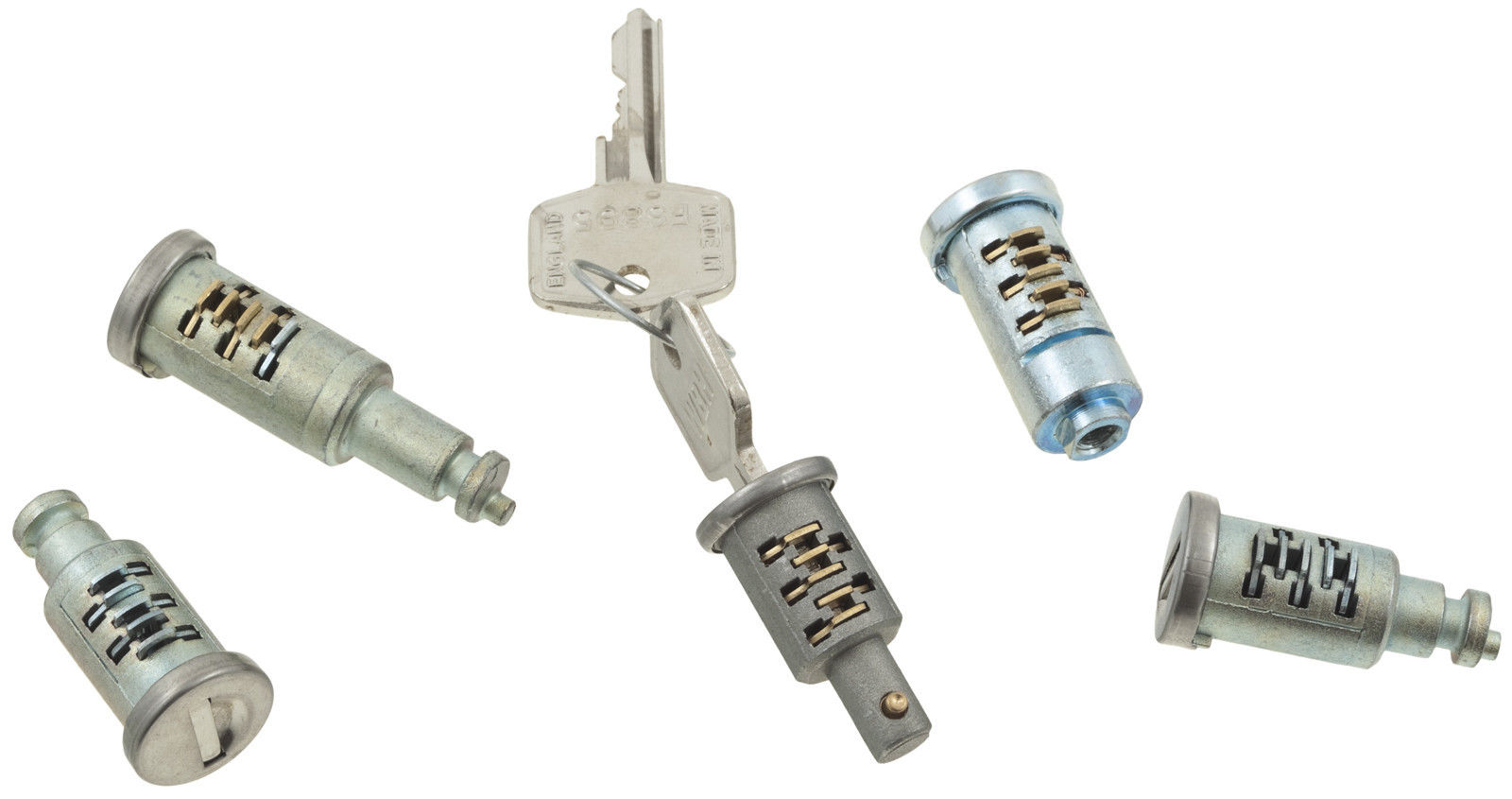

Finally got the old barrels out. One is marked FNR 5. They are available as a Weston Body & Hardware part. But only in a set of five different barrels from Moss Europe WB9-01302. So you're left with eight redundant barrels each four with the same key number that'd have to be copied too for selling on. They're part of the XK120/140 series.
I'm posting this in case anyone else has the same difficulties -- hopefully saving days (and hair) of 'phoning around. It's the second barrel from the left in the attached pix.
To get the old barrels out, the locking bar has to be tapped through which is "V" cut to hold the bottom off-set turning node. That node will break off the bottom of the lock.
There's a circlip at the top that needs to be forced through too.
